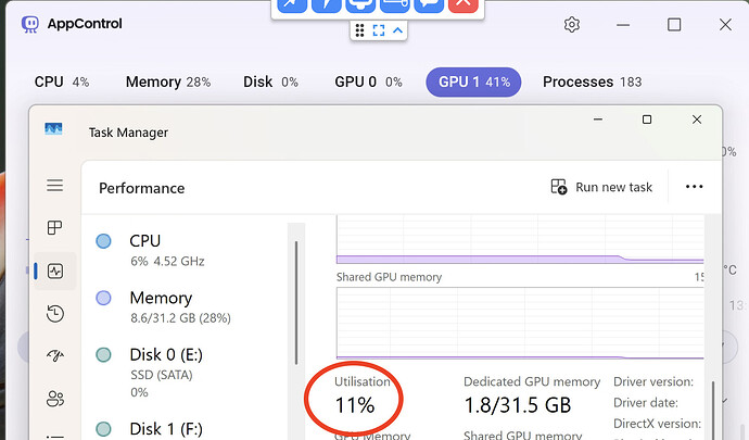

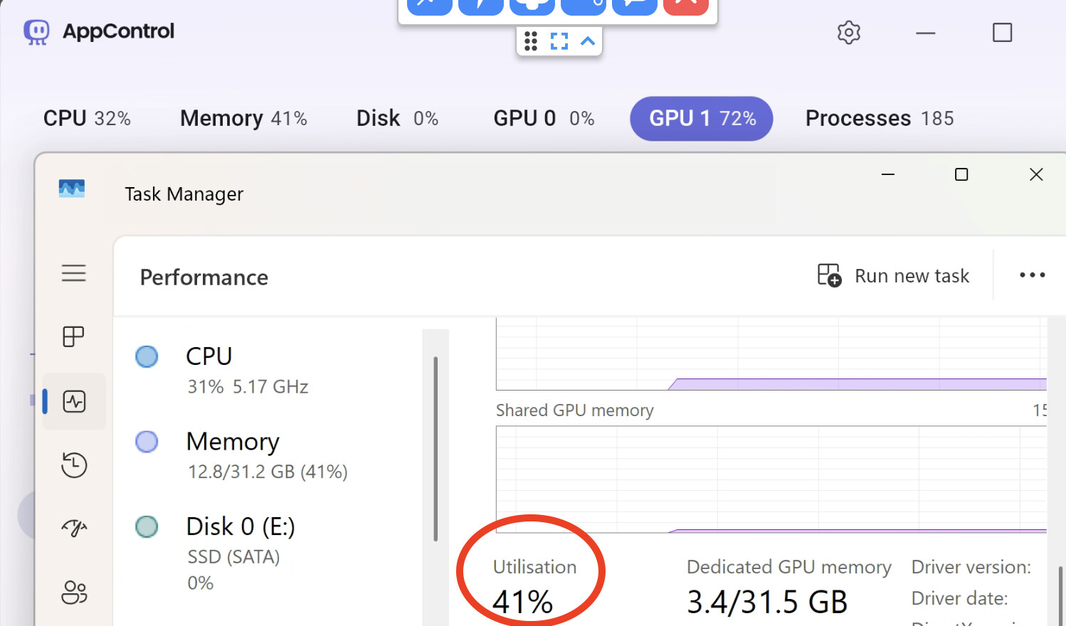

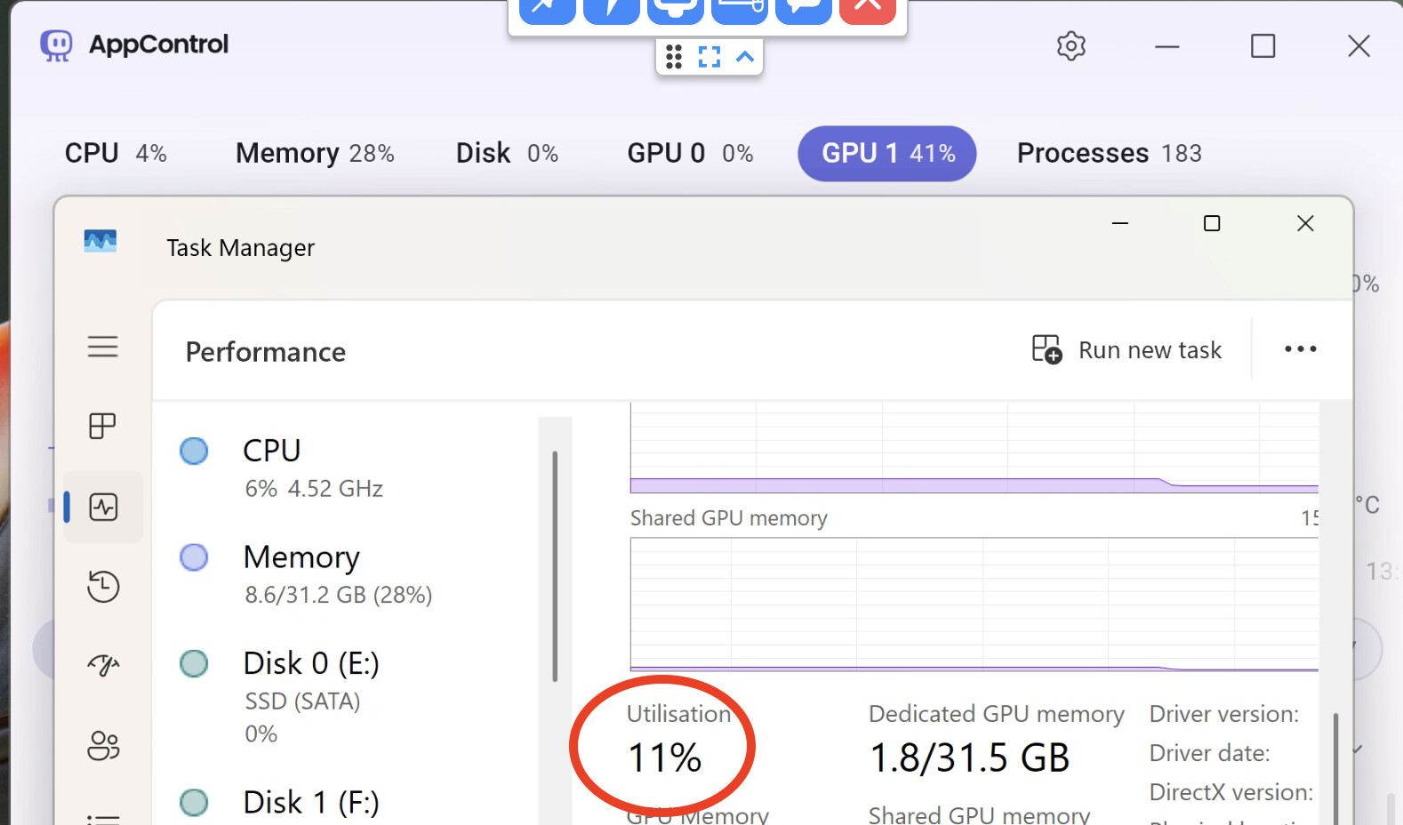

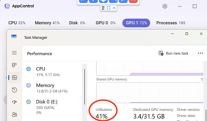

GPU reporting 30% higher usage than Task Manager
GPU reporting 30% higher usage than Task Manager.
See attached pictures.
Sorry for the issue. May I ask what hardware this is so we can try to recreate/fix it? Also, is this a virtual machine or something unusual?
If it’s something private with the hardware you can message me privately. Thanks for taking the time to report this so we can solve the issue.
Standard PC, not a VM. The specs are in the PM. Thanks.
Received the PM and responded, thanks!
We continue to try to reproduce this issue. If someone else is seeing something similar please post their hardware info. Thanks!

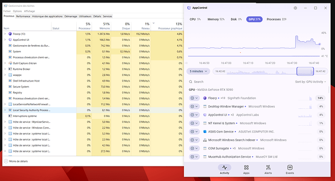

Hello,
Regarding the difference in GPU usage, I am experiencing the same behavior as @extranet.
In my case, the discrepancy seems to come from the GPU usage attributed to the browser Floorp (a fork of Firefox). I currently have a Twitch stream running in 1080p in the browser.
The Windows 10 Task Manager reports about 4.8% GPU usage, while AppControl shows 14%.
All other processes appear consistent between the two applications.
Personally, I tend to believe that the value reported by AppControl is more accurate in this situation.
I hope this information helps with the investigation.
My setup : Windows 10 + Nvidia 5090 + 32Go RAM
Another 5090. Strange coincidence?
Our team is still investigating, but I think this may be because we currently aggregate all GPU engines into a single combined usage value, whereas Task Manager reports activity per individual GPU engine (like 3D, Copy, Video Decode, etc.), so its breakdown can look different from our single total.
